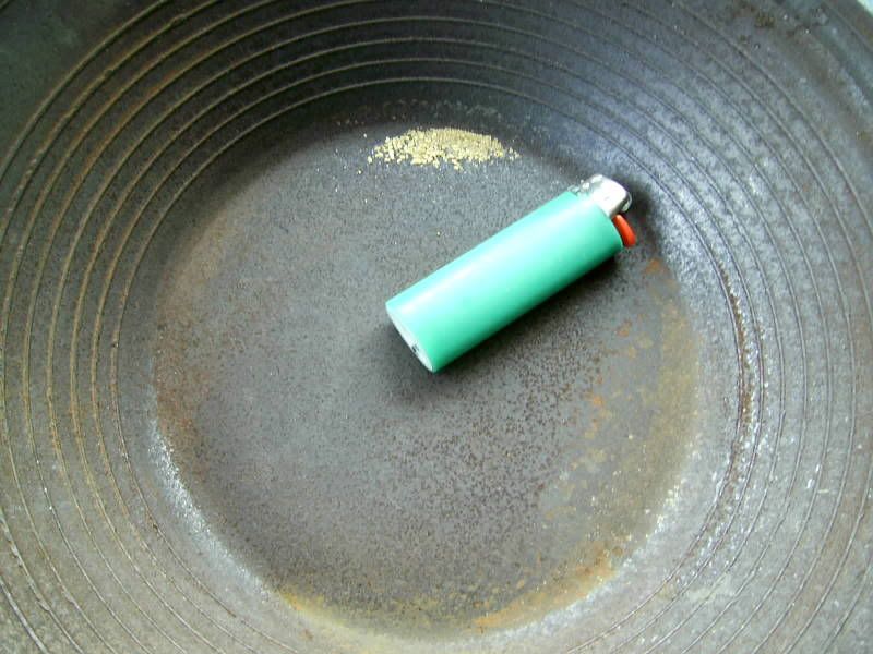

The end result from this one crevice

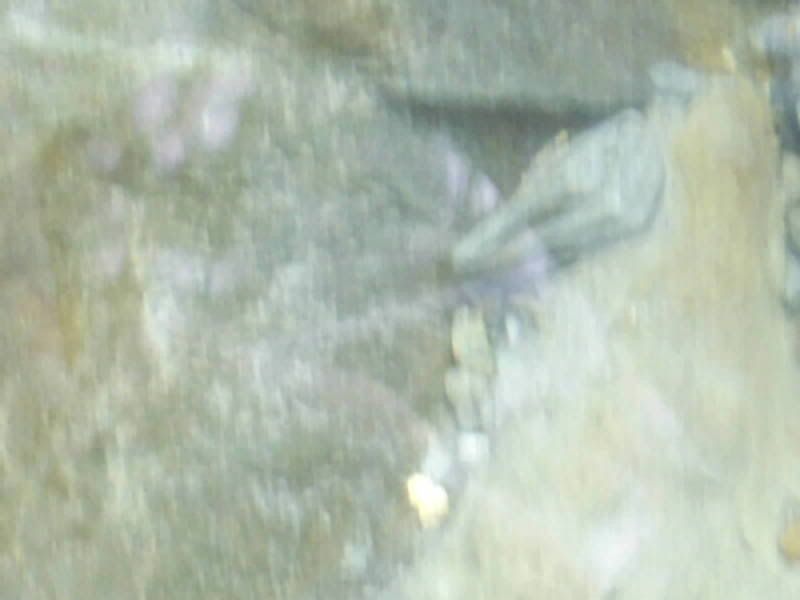

Here is some bedrock I was working on with my little 2" suction nozzle set up. You will notice the crevices I have uncovered
This is a pic of a little nugget at the bottom of a crevice. The camera focused onto the glass lense in the bottom of the view finder & not the little nugget so it is a bit blurry. But you should be able to see the piece of gold at the bottom & a smaller piece at the top
Result from these little crevices

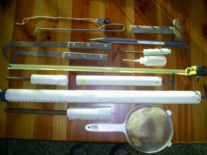

Sweet looking set up......what ever works....works...lol Like your home made dredge/highbanker.. :headbang: :headbang: :headbang:
:tongue3: I gotta jus' chuckle at the tool laid out pic--looks like a torture setup for the Marquis De Sade??? We do torture ouselves now don't we--fever thats what it is- a all consuming fever--and God I love it-John

Did you make that hand sucker yourself? I was thinking about trying to make one, but I don't have any plans for one. Do you know where I can get some plans?
Hey Kiwi, is the tape measurer for the great big nuggets? Good setup As H.J. says KISS
