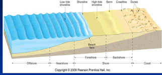

Tungsten & Gold Rings @ 11-13” in wet sand. Depth is very important when the ocean does shoreline build up and gives us some extra sand we dont really want as beach detectorists.
Deep cuts like these are NOT ALWAYS AVAILABLE
So DEPTH is a BIG DEAL if you hunt days other then low tide after a storm.
