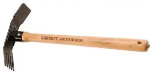

My Garrett Recovery Tool has an extremely strong magnet in the handle and it can be used as a digger too.
