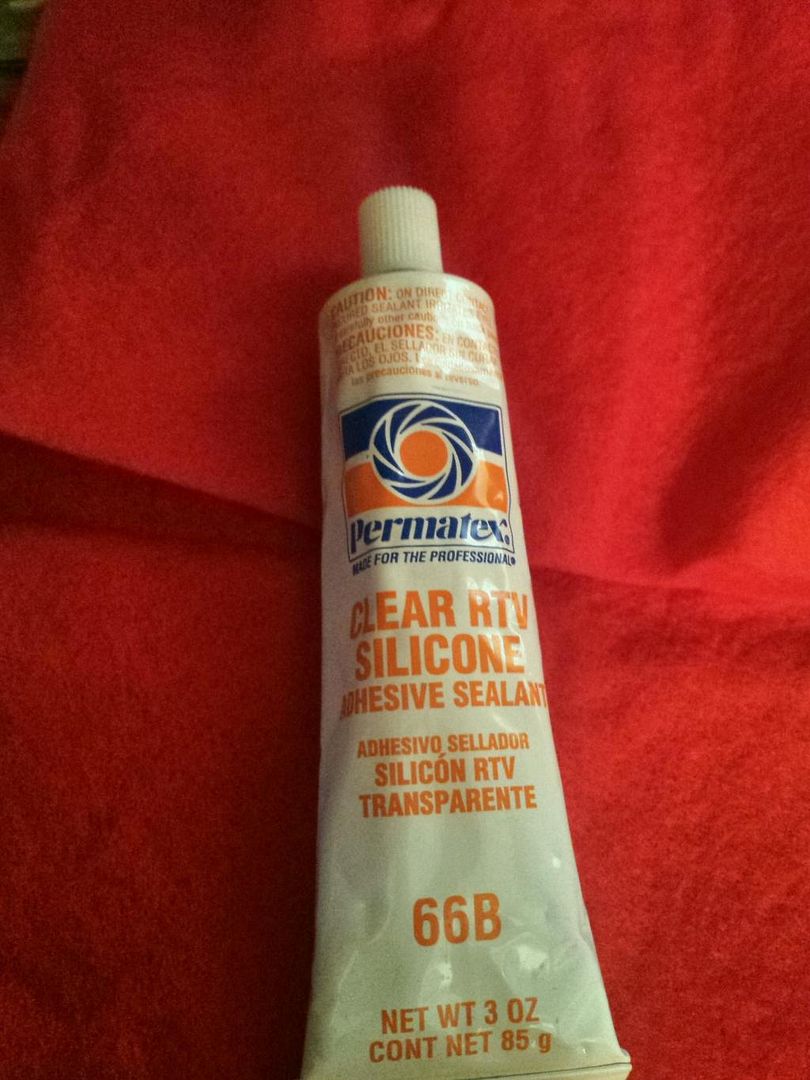

I wonder if this would work?
Yes, Permatex Clear Silicone is an Acetoxy silicone rubber composition with tensile strength > 1.5. Should work just fine.
1.5Nm is the max you should put. Just give a try..better than nothing!
