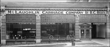

The McLaughlin Carriage Company was the largest carriage maker in Canada. The business was thriving, and even the emerging "horseless carriage" craze could not shake it. In a very humorous c1905 ad, an elegant McLaughlin buggy triumphs over the "fallen contraption". I have included a picture here of the McLaughlin Carriage Co. Branch in Vancouver, BC that likely sold the 'horseless carriage' this badge originally started life on.
