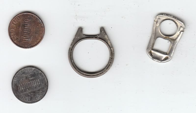

I went to two different beaches this morning and the tide was waaaaaaay out! Nice but just was not getting any hits. I got 2 pennies and 1 pull tab at the first one and at the second one I met another MD'er who did not introduce himself. Ah well I'm getting used to that. He did say hello and asked how I was doing which was ZILCH! I ended up finding one more pulltab before I finally gave up for the morning.
