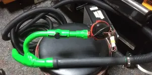

Here is my attempt at a 1" Electric Dredge. 750GPH pump and some PVC pieces. 25ft Hose. Once paint drys overnight and JB Weld cures overnight I will see if this pup works. I have a Lipo 35amp hour battery just sitting in a box for last 6 month thats super light weight that i will pair with this if this think SUCKS..... We will see.....:headbang:

No just not enough flow from the pump but back to the drawing board...
I have been exactly where you are now and I can hopefully provide some insight. Bilge pumps only produce low PSI (5-8psi common) so getting something to work good requires a more efficient Jet like an infinity jet. Even with a good jet the lift capability will only provide about 6" of lift above the waterline before suction is diminished to a point that starts getting poor. Add to that a long suction hose and even less suction is the result. The keys to getting a system to work well is keeping the hose short, the sluicebox underwater or very low above the water, and using a better jet. It can be done, just have to stay within the limitations of the pump.

When I first started trying to build a electric dredge in 2010 I came across this thread. I had already purchased a couple of bilge pumps to try and couldn't get them to work with a standard jet and so I was reading Reggie Gould's articles on infinity jets. I ordered a high pressure pump figuring I needed one after reading the thread. I had about a week before the new pump came in so I worked on building an infinity jet with a bilge pump and was able to get good suction. When the new high pressure pump came in I built a suction nozzle for it and was surprised that I had better suction with the bilge pump and infinity jet than I had with the high pressure pump and suction nozzle. Since the bilge pump is already sealed and made for an underwater environment it was an easy decision of which one to continue experimenting with. I have made a lot of improvements in the jet design since then, but the biggest struggle was how to get a sluice to work underwater effectively and I had to go back to the drawing board on that one many more times than I care to remember, I could fill a dump truck with failed prototypes. I guess the point of this story is that if your experimenting, don't give up and learn for yourself, take others input's as guidance but not as law until you can verify by testing. With each failure comes an opportunity to learn from and get's you closer. Good Luck to all my fellow tinkerer's.
