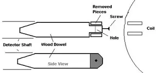

I had a shaft break on one of my detectors as well. I made a replacement out of a 3/4 inch wooden dowel. Here is how to build it; To taper the the end of the dowel to fit into the shaft, I placed a screw in the end of the dowel, then put the screw into my power drill. I used a piece of sand paper on the free end as the dowel turned in the drill. When the taper looked close to the correct size, I checked it against the shaft tube. Use gloves as the friction creates a bit of heat. Once the taper is finished I removed the screw and used a small dove tail saw to cut the sides off of the dowel about two inches up and to the correct width to fit into the coil. I then used the same saw to trim the corners off of the coil end of the dowel to allow the coil to pivot once the dowel was attached. Last step drill the hole. I fixed this detector a couple of years ago and it's still going strong. I have an Excalibur as well, the small set screw is to ensure the positive and negative terminals are hooked up correctly as you mentioned, just be sure to line up the hole with the snapped off screw and you will be fine. Hope this helps.
Thanks for the reply. I'm going to print your instructions in case my fix doesn't hold. Maggie
