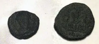

Hello friends! I found one coin but i have big problem with identification. I will try to clean, but now I can see only few things on reverse: 1) Three soldiers (legionnaires) or tree, letters between soldiers (tree) "?_IK_AN_?". In ex: AN.
If is a possible with this poor information and low quality picture, please help me.

Hello... it looks like it could be a coin of Julia Mamaea... Julia Mamaea. 4.14g; 20mm. Nicaea, Bithynia. 222-235 AD. IOVLIA MAMAIA AVG, draped bust right / N-IK-AI-E-WN, between and beneath three standards

I believe the only Roman mints to have "AN" anywhere in their mint marks were from Antioch and Arelatum/Constantina.
You may wish to continue your research there.

Dear Silver Searcher, I think that my coin is not Julia Mamaea. It looks like Gordianus for example. Definitely is male on avers.
One information more, coin is 19 mm.

Julia Mamaea was a complete guess, but I think the reverse is very similar with the three standards. I will look further. There are coins of Gordian111 that have the Legionary standards on the reverse, looking there might help your search.
