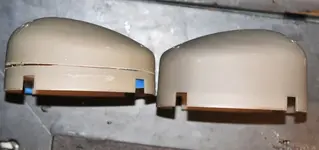

Thank you for posting this video. I am definitely going to do this to my excal2. I was curious during the part of the video when you cut the back shell of the peltor ear muffs for the transducers to slide into you said you cut an extra 1/4" off of the middle part of the back shell. In the video it looks like you just cut around your blue tape without removing the extra 1/4". Am I misunderstanding this part? I've watched it twice and am unsure. Thanks again. You did a great job and I would love to see an in depth video for how you added the screamer as well as your remote discrimination switch.
Re: Tired of those old Head Phones?
I 'll get you a picture of a uncut and the cut to show the difference and how much extra needs to be trimmed off....this afternoon..........joe
The cuts on this secondary Peltor shell are for the Yellow HeadPhone Excaliburs only. For any other excalibur or detector model you will need to measure and trim as needed. I think the others would be less, I have most of the popular water detectors and most Piezo transducer plates are flat.
