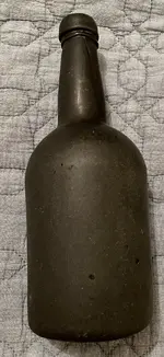

I found this black, pirate glass bottle today. How can I find its approximate age?
Look for a mold seam, pontal, could be a turn mold, 3 piece mold.
I'll say 1880-1885 date range, going on the one's that I have recovered in the past.

Your bottle is pontiled and likely dates to the 1850’s . Old, but not “pirate “ age.

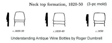

It's a nice one for sure. I'd say about 1820-1860.
