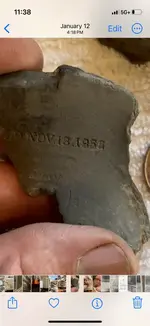

Found multiple frags of Sawyer artillery shell.
Question: will electrolysis damage the lead sheathing on the iron?

Cannonball, I found plenty more frags. Might add up to a whole shell. Found in a 50-75 yard circle. I realized a sawyer has a percussion fuse which, I guess is kind of like a ground burst. Any, I didn’t know what I had until I found this piece.
