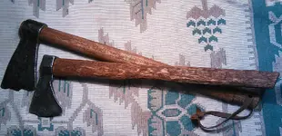

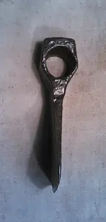

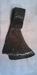

today I continued . In the fall 2012 I polished the axe head. Today was a little free time and I made the handle for an axe. The handle I made of a shovel shank. I processed it a knife what to give a type of handwork. That the handle would be similar to the original, it is necessary to make it old. It becomes by means of a metal brush, a sandpaper and a dark varnish.

tonight (we have in the country an evening: ) I did a handle for an axe and I varnished it for wood. Then of an old soldier's belt I made a leather thong and handle bandage.
Second Axe. Today prepare head of the axe.

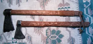

Today day off and I had time to finish work on restoration of axes. I made for the second axe the handle and I processed a textural varnish.
For each axe wedges were made: metal and tree. Probably I will make a special panel. On it I will fix axes.

Technology simple: with sandpaper I delete a rust, and with a metal electrobrush I polish metal. The tree is processed by a knife and as it is processed by a metal brush. Then it is covered with a textural varnish.
