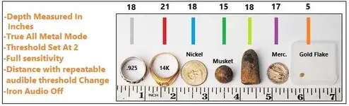

As previously mentioned, adjusting the threshold, to hear those soft whispers of deep targets and also to accommodate people with hearing loss, allows the user to get very deep targets and/or tiny targets often missed by others. This ability to hear those soft whispers benefits those hunting for gold nuggets, especially tiny ones. It also allows relic hunters to search deep. Deep targets are generally older. Often times, all you hear are soft whispers or a change in audio using the audio threshold. Should you dig those targets? Absolutely! For this air test I had the threshold set at +2, where I could hear a constant background hum. Measuring the distance from where a audio signal begins to repeat itself is where I tracked the distances today. I performed the air tests today in my backyard, where I could run the AT Max at full sensitivity. And what a difference it did make.:thumbup:
The above pic shows the depth (in inches) for the shown targets. I was using the true all metal mode, with the iron audio turned off. It is by far the deepest mode, and should be used when searching for known deep targets and areas not too trashy. It is also the preferred mode searching for those tiny nuggets, easily missed by other metal detectors.

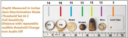

Here is an air test using the zero discriminate mode. Again, it was set up using a threshold set at +2, noting soft whispers or a change in audio using the audio threshold. These again were the measurements that were used. Although not as deep as the true all metal mode, it still maintains a very good depth. And don't forget, that the AT Series have some of the best tones to ID targets correctly.
