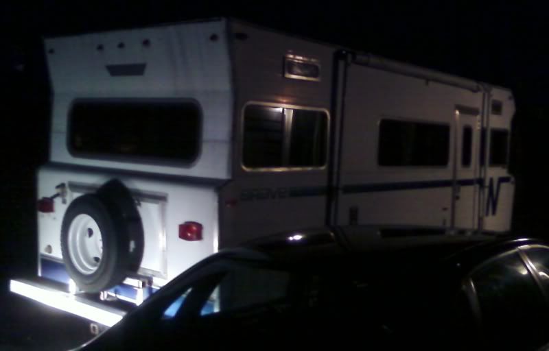

I just picked up a 1973 Winnebago Brave 22' RV the other day. Drove it home 40 miles without issue! Reason I bought it was because it has 56,000 miles on it and has a Chrysler 440 big block that I'm putting in my Ram.
On the scales this thing weighed 10,100 pounds. The entire body is aluminum! I figure even if a THIRD of that weight is the chassis and engine that's still about 3000 pounds of aluminum! At 80c a pound that'd be $2400 worth at the scrap yard!

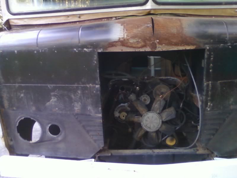

Getting there! This was about 3 hours work yesterday.

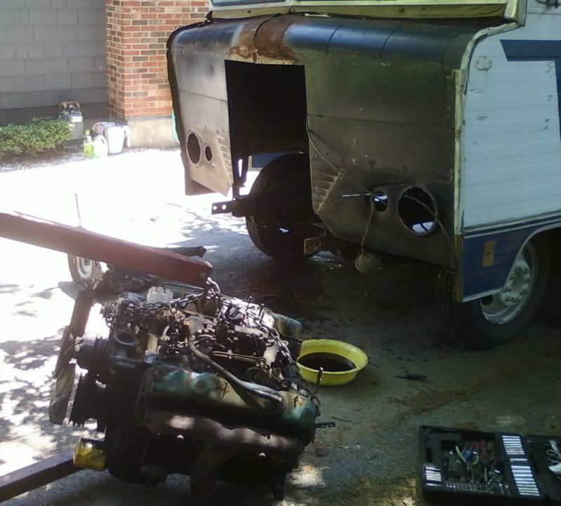

Got the motor out today. Turns out even though this is a 10,000lb camper it's just a Dodge Ram D300 (one ton 2wd) truck frame! Everything is the same... brakes, suspension, and most importantly, engine mounts! I don't even have to source mounts to put this setup in my Ram... gonna bolt right in ;D
From the last pic it looks like you got a forged crank 440 there! The trans should have some nice heavy-duty internals, too. Is it a regular length trans or one of the shorty ones?
It's all standard truck stuff so the tranny is the same as the one in my truck now; just the big block version.
