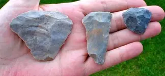

First off, outrepasse flakes. I've been bending my wits trying to figure the right-angle terminations and wide striking platforms of Joshua's out. Without success.
Illustrated here is a continuum of the outrepasse flake form I'm familiar with. These have a distinct bulb of percussion and run flat until they terminate in a sharply downward "hook," taking the knapped edge of the other side of the biface with it. They're arranged in an extent-of-reworking sequence, from left to right.
At left is a broad OPF from the Ohio/Michigan border. The center of the working edge is just beginning to be retouched into an endscraper.
In the middle is a narrower one from Kentucky. Its right edge is a fully developed sidescraper or high-angle knife and the distal end is an endscraper. The left side (very thin) is being used occasionally as a knife.
At right (same area as the first) is pretty close to the end of the line for a tool on an outrepasse flake. The endscraper edge is still functioning, but the rest of it has been reworked and/or broken away until it's a thumb-scraper.

Re: Some Paleo Tools for Joshuaream
Uniface,
I'll take a couple of shots when I get home this weekend. The OPF that I pictured are missing the bases (percussion areas), what you are seeing is where the flake crossed the midline of the biface and took out part of the opposite bifacially flaked edge creating a sturdy awl. When I found my first one, I just figured it was a mistake that someone used. There have been about 25 examples that have come from the site, and I don't think they were mistakes anymore because of the common traits. I've got a couple broken bifaces that show this removal, I'll picture them as well.
