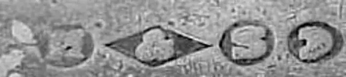

I found this old spoon in a junk box at a thrift store. I think it might be silver. It doesn’t stick to a magnet. Does anyone know how to read these codes or markings? Any idea where it might be from?
Thanks for any help. It was found in Michigan, if that gives any clues.

I found this: Otis G. Carter, Sr. Norwalk, OH 1831-1854 and 1860-1901 I believe it is coin silver....Nice find. Shining silver does NOT effect value.
You have a very good eye - yes, you have silver, but I don't have a hallmark book to help with date age.
John S Putnam c.1835, retailed O G Carter, Chicago 1850. Appears to be a Fiddle pattern.

Good spoon, but it has nothing to do with John S Putnam. The spoon was made for (not by) Otis G. Carter and is the work of Hotchkiss & Schreuder.
Carter was a watchmaker and jeweller active in Norwalk, Ohio from 1831-1854; Chicago, Illinois from 1854-1860; and then again in Norwalk from 1860-1901. He didn’t make spoons, but those made for him carried his name as the retailer.
Putnam was one of several silversmiths who produced for Carter, but this spoon carries the maker marks for Hotchkiss & Schreuder. The mark may look like ‘N & S’, but the first letter is a worn ‘H’.
David Hotchkiss and Andrew B. Schreuder entered into partnership as “Hotchkiss & Schreuder” in 1857 at 95 Genesee Street, Syracuse, NY, continuing until 1871 when Schreuder went solo. So that’s the timeframe for the spoon. It will undoubtedly be coin silver and .900 fine but, as AARC says, not produced from melting down actual coinage.
