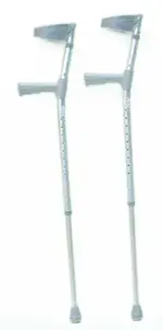

I don't know how heavy the Minelab shaft is and the following may not be the solution but in the '80s I was in Las Vegas and left the detector in the trunk of my car overnight. The next day it was about 200 degrees outside and about a 1000 in my trunk! Seriously, it was hot outside and in the trunk. When I picked up the shaft by the plastic elbow rest it disintegrated in my hands and I was left with just the rod sections.
I was going to order an elbow rest from Teknetics but before I did so I visited a thrift store and they were selling a pair of elbow crutches (see photo below) for $5! They were the perfect replacement and I think they are made of aluminum. The slight angle is an improvement over a straight rod and maybe even an S-shaped one. There may be slight variations but they're mostly all the same.
