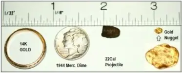

Below are a couple of graphs depicting various maximum detection depths using air as the medium. Now depths of targets will vary due to their size, soil mineralization level, conductivity and oxide formation on the surface of the target. The depth will also be in your favor with a soil matrix of low mineralization and the length of time the target has been buried. Now, anecdotal results from hundreds of users using the 5" x 8" suggest it is in fact a superb coil combination, getting extreme sensitivity resulting in excellent depth capabilities and excellent separation abilities in areas covered with junk. I too have the 5 x 8 coil on my AT Gold at all times and it has been fantastic relic hunting machine for me.
The extreme large after market coils don't work well in trashy areas nor do the perform that well in mineralized soils, where the sensitivity must me lowered to run them stable. This can result in some depth loss. On the other hand, hunting in areas with little amount of junk targets with low mineralized soils, the large after market coils can give much better depth then machine costing 3 x as much as the AT Series.
Monster coils and coil sizes
