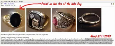

Of all the gold rings found in wet sand or water at the beach, how many were deeper than 12"? For myself, the vast majority of gold has been between 5" to 10" deep. My deepest was in the dry sand at about 16" deep. Most found with an 8" coil on a Tesoro Sand Shark. :skullflag:
Seems they can be just about any depth here, several times I can get a spot where it is loaded with older coins and in the mist of checking the hole after digging them I find a gold ring on the wall or just deeper. A few times and just recently I've dug a deep wheaty, then there was another a foot away. They were in the area of 12 to 14 inch's, as I was doing my circle I got a solid hit, like a fresh drop..gold ring..in the dug sand I had thrown to the side. Then a few years ago, we had a spot that we wore out. Until we realized by just digging a hole we could find gold rings and silver coins, Mike and I called it mining. And just from hunting maybe 15 beach's in the last year 5 years, many times. I see a pattern...And remember this is in the water only, where sands shift...
On another note I had a honey hole this past july..37 gold rings in 32 days. All in the deeper water, chest to chin deep. Some how mother nature opened a area up, cleaned most of the sand out...targets where every where..but mostly just rings and most were gold. Since I have to play the tide games I was only able to get into the area 15 times in that 32 days..every hunt I found gold, shallow I would say..mostly 6 to 12 inch's (variations because the bottom/slope is not perfectly flat). Never had them that shallow before, Then Bam..A Northeaster came in for a few days... and filled her back in...Gone, covered..I can dig down about 2 feet and hit the crunchy shells that holds the gold...it's there I just can hear it...
I could continue with the stories but I can Honestly say, I know the spots I hunt very well, it changes I will noticed it.
I need deep...Please
