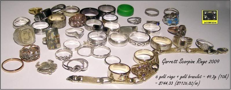

The season should be wrapping up soon. I sorted out most of my jewelery, and used the Scorpion for most of my land hunts. Shown are 6 x gold rings + 1 gold bracelet, along with mostly silver, stainless steel and cheaper costume jewelery.

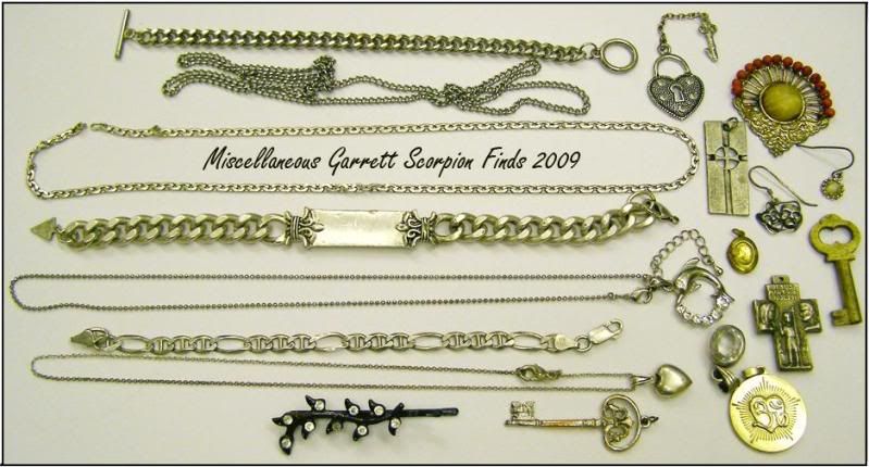

Here is some miscellaneous jewelery, also found with the Scorpion this year. Most of the chains are silver, but there are also some metal ones too. The Scorpion Bangs hard on all of these.
