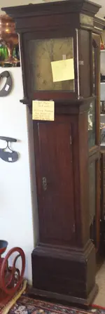

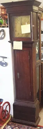

An antique shop has this clock for $190, though I think I might be able to get it for $160 or $170, based on previous experience there. I'm curious as to how much this clock is worth, if I am overpaying or not. I'm also curious as to how old it is, I read somewhere that brass faces predate 1770. It is listed as "AS-IS", though I think it might work.

Coinman, I found this one that the cabinet is sooo close to yours. Liveauctioneers, listed as English 18th century. It has a different face, but the cabinet is nearly identical, including the lock plate. It sold for $600.clock1.webpclock2.webp
Even chime door bells are between 3 & 600 now. If of works, its a bargain IMO.
Nice piece there.
At that price, I'd but it even if it didn't work and have a horologist have a look at it.
Maybe you can look inside it ? Many times they have a date of when it was in for service and this can possibly narrow it down a few decades. Nice old clock. Kray Gelder did a nice job in finding one that close.
Kray nailed this clock with his assertion that it's likely 18thc or early 19thc. :thumbsup:
If the original works are still in place (not replaced with a modern movement) then this clock is worth a lot more then the $190.00 asking price.
I think it's important to compare the pic of your clock next to the example that Kray found, as they look darn close.

I decided to buy it, $190, bringing it home tomorrow where I will follow up with more information. Everything is there, weights (It's a double weight clock), chain (attached to where it should go), pendulum etc, just laying on the bottom of the clock case. Original movement is there too. When I move the area where the pendulum should attach, the minute hand moves a little bit clockwise, which shows that the movement probably isn't frozen. The seller said he just bought it, and immediately put it for sale there, selling it AS-IS. I doubt that it works, considering how old it is, but it will certainly be a fun project anyway!
It also has rose head nails used to construct the cabinet, which suggests that it might be pre-1800.
Expect more photos tomorrow!
The face says, "Benjamin Goldsmith" "Halsham". I figured that records of a Benjamin Goldsmith in Halsham Yorkshire should be pretty easy to find, but I haven't been able to find him so far.
Also, looking at the movement also let me immediately identify the weird brass thing that I found metal detecting as the bell from an old grandfather clock. It's a 100% match to the brass item I found at a cellar hole!
