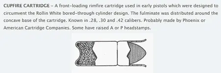

If I am seeing it correctly, it looks like you have found a rather rare cartridge. It looks like a cupfire cartridge.

Just another thought it could be a pin fire round given the hole in the side. The thuer had a primer pocket which yours doesn't have. HH

It definitely looks more like the cupfire cartridge, as it looks just like the picture that turtlefoot posted...it even has the rim indentation half way up the casing like the one in the picture. The cupped area on the back end of the casing does look like it was made that way, and not something someone did later out of boredom, etc., it is too uniform for that8-) If it is a cupfire cartridge, what would it date from? And how rare is this bullet? Thank you very much guys, I really appreciate your assistance in this:notworthy: Chris
Awesome link...Very interesting!!! Thank you very much for that turtlefoot:occasion14:
