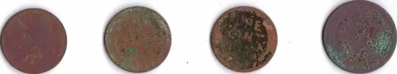

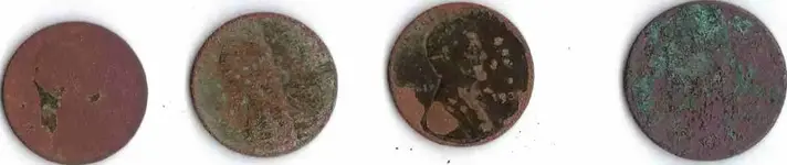

Well, the rain finally stopped. I quickly grabbed the XLT and headed out to an old youth camp with an open field. I only had a couple of hours before it would get dark but I kept the swinging steady and consistant. Along with the clad money I found three Wheaties: 39, 40, and unreadable. I also pulled out a V nickel. I'll be real lucky if I can ever pull the date off of this one. it is very worn and very corroded, but a "V" nickel is still a "V" nickel.

Hey..you must be hunting in my territory. My coins have that same high quality patina! :wink: :D

That would be excellent! Appreciate that. Not in all the areas I hunt do the coins look like this but in this particular field the red is on everything including the clads.

As it turns out. I was able to clean that nickel up and I got a date off of it. It was still very dificult to read but it's there--1912.
