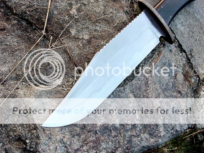

As a knifemaker, I have done much with vinegar. The following pic is a bowie I made with a hamon-line, that I made more visible by applying hot white vinegar with cotton balls.
Vinegar is acid, and acid will eat away the softer parts of whatever you apply it to first, leaving the harder spots for last. White vinegar is distilled, and thusly much more potent and stronger than ACV. Probably good to keep in mind.
