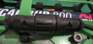

Order sheet and simple detailed instructions for install and proper use--kit costs aprox $60 depending on how many coils you want to run . (Seperate order from an electronics supplier). Easily installed--no soldering.
These are secure IP68 rated connectors. Excalibur users: Run the 800, 1000, WOT and NEL coils all on one machine. Also includes Sovereign jumper instructions.
Example photo shows my Excalibur 1000 and Sovereign that both run the 800 and WOT coils too. (Or any U/W detector).
Great versatility!
Install support included. A customer writes:
As for your water proof connector... Outstanding!! The instructions and installation were perfect.

Can you or do you have this type of connector for changing the headphones? I would like to use a set of the GG waterproof on my Excalibur, but don't want to take it apart.
Ten
That's certainly do-able--you would need to know the number of wires so as to order the proper carrier. The actual connector would have to be kept still too. The Aquasearch used to come with a small w/p connector but it was not that reliable. This one is a bit bigger but I know what to order and exactly how to install and use it.
