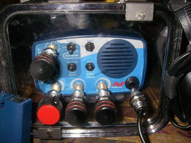

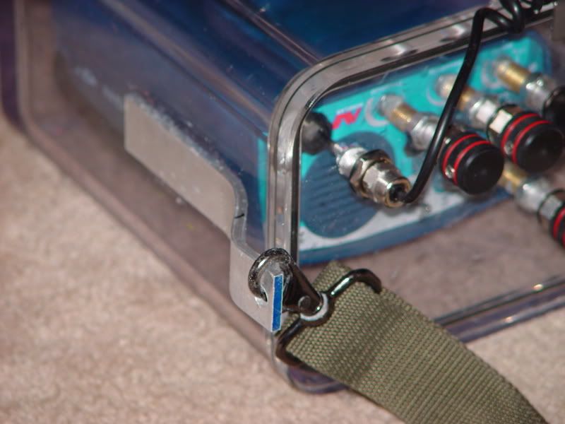

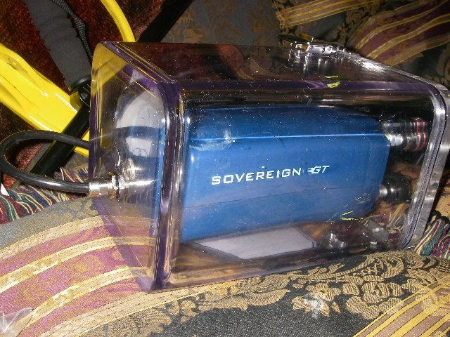

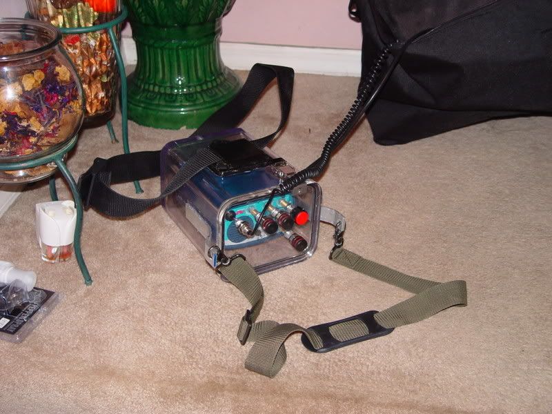

Here are pictures of mine, it is in an Ikelite waterproof camera case. It has never leaked a single drop, and can be used as a life preserver.... :laughing9:
While walking out to an outer sandbar one day, I misjudged were to cross and walked into a trough between the two sandbars about 7 foot deep, I popped up to the surface because of the case and used it as a float to get to the outer sandbar. I can't dive with it, but I can hunt as deep as I can with my Excals, I just release the waist belt and use only the shoulder harness when I am chest deep.

Most of the controls were extended to the outside of the case, he left the switches for Iron mask, Tracking, Silent Search and Noise Cancel inside the case which is fine with me as I don't adjust those often during a hunt..
It is hardwired into the case at the moment. I am thinking about putting a waterproof connector from the same company the splices for the WOT come from on the bottom of Ikelite case instead of the hardwire, then I can quickly change out coils on the waterproof Sovereign GT if I wish or need to.

Well to be honest I have never weighed it. I use a dive belt and a shoulder harness when I hunt with it to help distribute the weight so its not all on my waist. I will weigh it and post it later.
