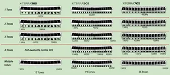

I found this .... not a chart to show what the target is but this shows the tones and what sections you hear for how many tones you choose (1,2,3 or 28) .... nice little extra info to know about the bottom notch bar based on what areas fall into what sound category .....
I hunt in 28 tones pretty exclusively, but for a newbie to the 705 fewer tones can be easier to learn initially. Relic hunters will often run 2 tones, because they are going to dig everything above zero anyway.
