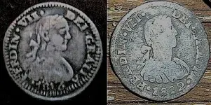

I have looked and looked and just could not find a similar coin from that mint in the same year group and being a Half Real. But, I still am suspect of the crudeness of the lettering and the date. Afterall, the mint mark was of one of the Royal mints and the statement I found on the interent which I attached seems to indicate that crude coins were numerous and of low quality silver, meaning the weight could be right or heavier but still a counterfeit. Then only a Specific Gravity test would help determine whether it is more silver than base metal.
Here is a statement I found on the web:
In terms of War of Independence "one from each major mint" set, I think going with Royalist Provisional Mints would be the best direction, since Insurgency created numerous local, crude issues in low quality silver that later were melted down by Republican Mints.
Royalist Provisional Mints of the Mexican War of Independence:
Chihuahua Mint 1810-1822
Durango Mint 1811-1821
Guadalajara Mint 1812-1822
Guanajuato Mint 1813, 1821-1822
Sombrerete Mint 1810-1812
Zacatecas Mint 1810-1822
I only suspect counterfeit due to the uneven lettering and the uneven date, I have no idea what the bust should have looked like for that year. It is entirely possible (I guess) for that year the coin was made from crude dies.
Here is a side by side comparison of an 1812 Half Real my son found this year (Mexico City mint) with the 1816 Half Real in this post. Posted just to show the difference in lettering and date.

Don in S. J.
The 1/2 real, silver, armored bust from Zacatecas has three varieties. The first is dated 1811 or 1812; the second is dated between 1813 and 1819 and the third is dated 1820 and 1821. The reverse of the earliest dates states MONEDA PROVISIONAL DE ZACATECAS around the circumference. The 'middle' variety states HISPAN. ET IND.R.Z.M.A.G. and the 1820 and 1821 variety states HISPAN. ET IND.R.Z.R.G.
Dirt Doctor's coin is of the second variety (1816) while the one you posted is of the first variety. This may explain, in part, while Dirt Doctor's and your coin differ, other than in the date.
I have no idea of whether or not DD's is counterfeit.

Mackydon, if you reread my post I said my son's coin is Mexico City Mint, so it is not any variety of the Z mint. I am pointing out that for a coin to be from a Royal mint as in the quote I posted from the internet that the lettering and numbering should not be crude like DD's coin is. The statement I posted said crude examples were made during that period, and DD's coin looks somewhat crude compared to the Mexico City mint that I posted along side of it.
Again, weight cannot always be a determining factor, without all the all the other data. Diameter and Specific Gravity. Base metal can be mixed with the silver to raise the weight .
A photo of a legit 1816 Half Real, would really help, to see if the dies were made crudely or not. :)

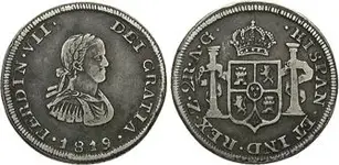

Here is an 1819 2-reales authentic coin from the Zacatecas Mexico mint. The face looks similar to yours. This is a very rare coin (worth over $150).
What is the diameter of your coin?
- Moe
- Moe
18 mms . I'm looking for my micrometer to find the thickness .
