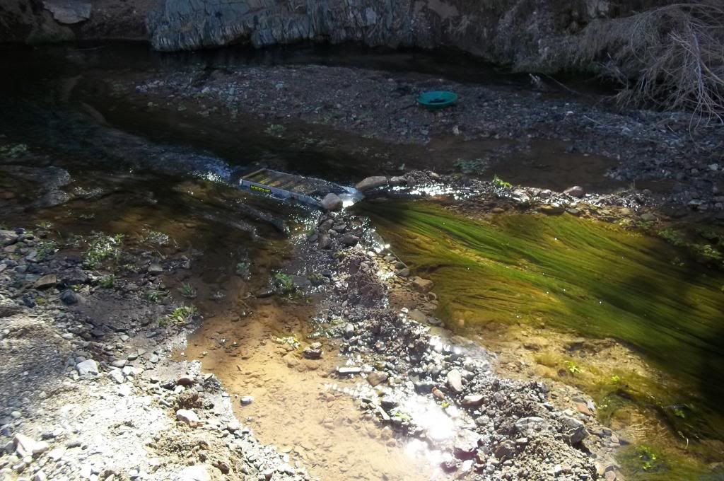

My A51 seems to work well when there is plenty of water, which is not so easy in AZ...
I had to engineer quite the dam to get enough flow to clear out the small gravel, even after classifying down to 1/4".
