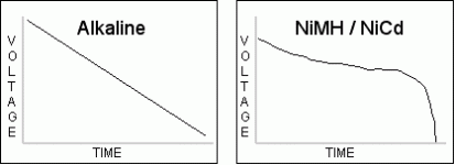

I've used NiMH in my previous XLT and am using them now in my MXT and IDX with no issues. Couple of other points that haven't already been covered by the other posters, check for any black tarnish or other strange deposits/goop on your batteries. That may prevent proper contact. Use a proper NiMH charger as a Nicad charger may not properly charge them fully. Or you may have had one bad battery.
Although NiMH are only 1.2v per cell and 8x1.2v=9.6v versus 12v for 8 alkaline, the XLT/MXT runs just fine on that voltage. Alkalines lose their voltage gradually -- as opposed to rechargeables like NiMH or NiCad which maintain most of their voltage over the whole charge and then suddenly plummet. (Be aware though, as stated earlier, that NiMH do lose voltage over time if not being used, so charge them again before going out if you haven't used them for a couple of weeks. The new Hybrid NiMH have all but eliminated that problem now.)

I've got NiMh in my XLT and it works fine. While they are rated at 1.2v they charge to 1.5v and drop to 1.2v and stay there for most of the discharge cycle. The graph GpSnoopy put up is a great example. I charged my batteries a few days ago, hunted 2 hours this morning and the voltage check is still showing 10.6v
