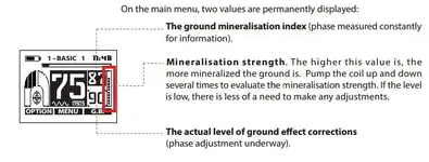

I was wondering if anyone out there with an 11" coil could give me some feedback on this question. On the far right of the main screen when hunting, there is a vertical bar that will display a number of bars, based on the mineralization of the soil, if you pump the coil. This works great with my 9" coil and will display a bars in the vertical column. However, in the last year I have not ever been able to get my 11" coil to display ANY bars in the area. This is in the same soil that my 9" coil will display bars. So I was wondering if any of you guys could try with the 11" coil and pump it to the ground and see if it will display any bars.
I highlighted the vertical area from the manual screenshot below.
My concern is that there is something wrong with my 11" coil. I've had it for a little over a year and if there is a problem, I'd like to contact support and send it in. But I figured I'd first check with someone else and see if theirs display bars.... perhaps that graph just doesn't work with the 11" coil or something since my 11" has never displayed any.

Do the bars stay put after you pump the coil and sweep it on the surface or does the bar rise and fall while pumping and otherwise go away while sweeping?

I've only seen the bars fill the vertical mineralization area when pumping it. They always go away when you sweep... which I believe is the correct behavior. The GB number will change as I sweep, but those bars I believe are just for pumping to get a visual level of mineralization. I'm just concerned because my 11" doesn't seem to work at all in that vertical bar graph thing. I'd be interested in seeing if others have a different behavior.
What is happening is that your 9" coil is more sensitive to ground feedback for whatever reason vs. your 11" coil. if you have no bars when sweeping then your soil is not mineralized. I would be concerned if while sweeping one coil showed mineralization and the other did not. For pumping all bets are off because you are moving your coil in and out of the mineralization field (however slight) and your mineralization bargraph is reacting to that change in reading which is how it works when sweeping (mineralized ground has has lots of variations in its field and the mineralization bargraph reacts to that). At least that's how I think it works ;) I have hunted true mineralized ground and the bargraph definitely increases and stays at several bars while sweeping (and just like conductivity, there are area to area variations in so the bargraph changes heights when I move around a mineralized area). Hope this helps.

Thanks man. Great explanation and makes sense to me too. I would think if one coil was more sensitive to mineralization they would have calibrated the software to adjust that bar graph for each coil... rather than having the 9" show half bars and in the same soil, the 11" show no bars. Out of curiosity, what sort of GB numbers were you getting in your mineralized ground?

I just spoke to Moe. Didn't explain why you 9" would show minerals and not your 11" but said you shouldn't see any. He said the bar was made for Europe where Coke is abundent in the ground.

I was getting the normal conductivity range of 75 to 90. Did not notice if it varied a lot, but kept tracking on so I didn't have to pay attention to it as closely. I was getting good at identifying audibly the sound of hot rocks in that soil. Since the mineralization bar is just an "operator aid" and does not affect how the machine acts, I wouldn't worry about it, especially if you seldom hunt in truly mineralized ground.
