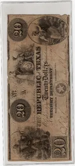

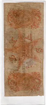

Thanks, you guys are great. Ok, so let me have it on this item also. Crossing my fingers....
It looks genuine with the appropriate "wear and tear". Signature ink matches the age of the note. But I'm no expert when it comes to paper currency. There is a paper currency forum on TNet that you might get a more authoritative opinion.
bwilliken,
Welcome to Treasure Net !!
A "Texas Obsolete" similar to yours, but in excellent condition (63) sold a year ago during a Heritage auction for $633.50. You might check on Ebay under Completed Listings (or similar wording) for other similar bills that have sold more recently.
