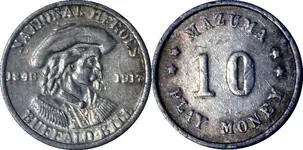

The bent looking coin below the ring is actually a 10 cent play money (aluminum?) coin with Buffalo Bill on the Front...This play money came in "Mazuma Bubblegum" packs back in the 1930's (pic attached how it should
look) The play coin was completely folded in half...like a taco, but flatter...got home, seen writing on it...bent back open. (creased)
