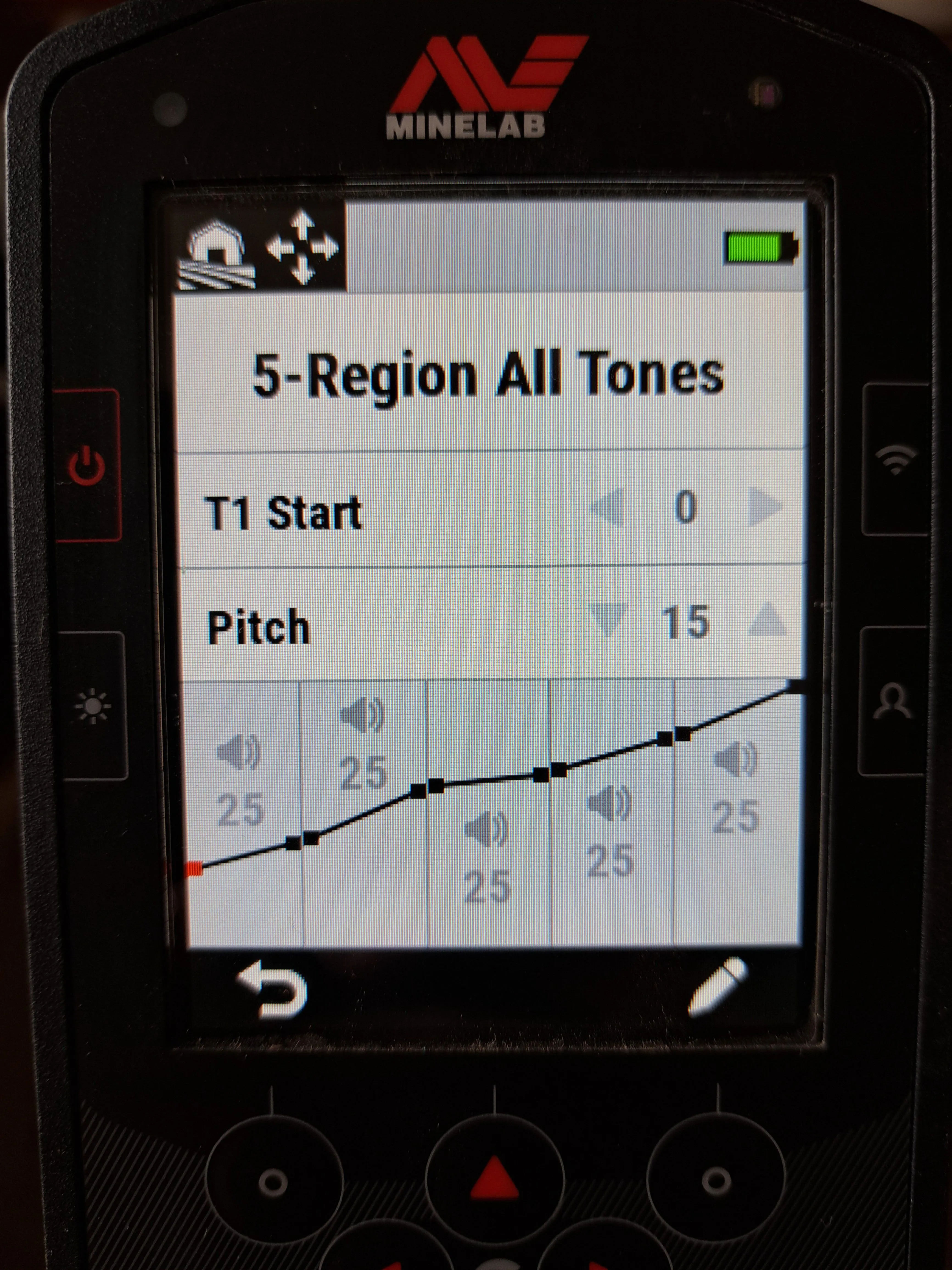

So here are my settings on the Manticore 5 region all tones. I'll continue to fine tune the adjustments but for now, I'm happy with the results and how the tones seem to match up so far.
T1 Region 0-19 T1 Pitch 15-20
T2 Region 20-39 T2 Pitch 21-30
T3 Region 40-59 T3 Pitch 31-33
T4 Region 60-79 T4 Pitch 34-40
T5 Region 80-99 T5 Pitch 41-50
This is what the tone graph should look like with the above settings entered.
Like I said it's not a perfect match on the tones but it's pretty darn close. I have not field tested this set-up yet but plan to this week some time. It's easy to change the tones and do a factory reset if you don't like it. Feel free to give it a try or if you have a set up that works better, feel free to let me know.
