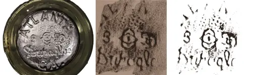

I have two 10-2-4, "Good for Life" bottles. One of them has the city it was bottled in as well as the Owens-Illinois Glass Company mark embossed on the base (The rest is debossed).
The other has no bottling information, is slightly shorter, and the glass is nearly twice as thick on the base (debossed as well).
I assume they're around 1930, but I can't explain the differences in bottling info. Any help?
I just found that on the first bottle, the mark goes as follows: 3 "I-in-an-oval-superimposed-on-an-elongated-diamond" 50
The 50 is supposed mean 1950, but the city it was supposedly bottled in was Atlanta. That bottling factory in Atlanta wasn't started till the 60's. Also, the code for Atlanta is 10, not 3. I'm hopelessly confused.

Sorry I haven't responded for so long. After a month or so, I figured no one knew and moved on. I'll have some pictures of the bottle up shortly. :)
On the first picture you can see that it says "ATLANTA GA." as well as "3-OI-50" with an "S" superimposed on the "50". So it would have been bottled in Fairmont 1950? Then what of the ATL business? Also, why is the 1930's bottle being produced in 1950? Thanks for your help!
P.S. I also found some embossed numbers on the very bottom of the bottle. On the front it says "C 1289" and the number "12" is on the back. Not sure if that's important.

Hello Caleb,
Owens Illinois was a glass manufacturer, not a bottler. The bottle was made at the Fairmont, WV plant in 1950 for the Atlanta bottler. Duraglas was a patented Owens Illinois process that debuted in 1940.
I'm not sure what you mean by "1930's bottle." This style bottle was used for many years. The other numbers may refer to mould numbers or customer information. I do not know.
