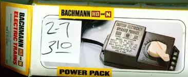

I use a Small Train Transformer, with small trickle charge. If the transformer gets too hot , I just un plug it and it reset's when it cools down, I believe the setting starts at 10 thru 100. good luck goldnugget P/S, I'm cheap, found mine a Goodwill Train Transformer.webp
