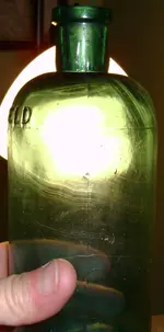

Well it's the slow time of the year so I thought I would post a couple of bottles that are somewhat rare. The aqua bottle is a Dr. Henley's IXL California Bitters and is from the 1870's. It's 12 and a half inches tall and has a manufacturers mark on the bottom- W. Frank & Son Pitt. You can see some of the original foil still on the neck. The teal colored bottle is a Duffield. Samuel P. Duffield was the predecessor of the drug company Parke-Davis. He hired Parke and Davis in the late 1860's and retired in 1871. I have not found any info. about him selling any of his products after 1871 but this bottle has a tooled lip. The side mold seam runs up to the very bottom of the shoulder and their is a mold seam around the diameter just below the Duffield embossing. Is this a 3 piece mold or a 4 piece mold and did they make this type of bottle in the late 1860's to early 1870's? The manufacturers mark on the bottom is Wm. McC. & Co. (William McCully made bottles from 1841 to 1909.) Thanks for any info. and feel free to post your rarer bottles so we can check them out.

Nice bottles, Wolverine! The Duffield bottle sounds like a 3-piece mold (the bottom of the mold by convention is not counted). Three-piece molds were commonly used for most of the nineteen century. Maybe Surf can help you with the research on this one.

Thanks Harry and Bass Assassin. I was just looking at the B.L.M. bottle web site and according to them the bottle is a 4 piece mold. A 2 part mold for the shoulder and a 2 part mold for the main body so you could change embossing or lengths without having to get a new mold made. I didn't give a date when they started making 4 piece molds, so it's still a mystery if this bottle fits the time frame that Duffield, Parke and Davis was in business together. A couple of years ago a guy posted a bottle that looked like the Duffield but had Parke-Davis embossed on it.

There should be no ambiguity here. Either the bottle is a 3-pm or it's a 4-pm.
In my experience, 4-pm bottles are uncommon, much less common than 3-pm bottle with shoulder embossing. I am not aware of any on my shelf . . . except for a few, very large demijohns.
Your Duffield bottle has the shoulder embossing appropriate to a 3-pm bottle; but, we can't make out the seams in your images. So, which is it?

Thank's for the comments Harry and here are some pictures of the mold seams.

Funny, the vertical seam isn't as strong as the horizontal. Nice pictures.

Harry i'm pretty sure it's a post bottom mold. What do you think.

I think you're correct, Wolverine. All-in-all, an interesting piece just from the standpoint of its construction.
