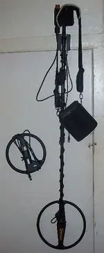

Go with the E-Trac and sun ray probe and yes mount it on the upper shaft , i did my Sov.GT that way just below the arm cup lt is a great tool and gets good depth on targets when finding them in a deep hole Good Luck Jim :thumbsup:
