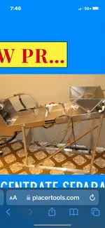

You could try and make a damper from a piece of aluminum, or maybe more than one. Something with a sharp edge that will slap down the tumbling partials and force them under water. The fella who owns placer tools has a fine good recovery unit that uses what he calls a “gate” ( I believe). It’s a bar the water has to push under making sure all the sand and gold is under water and not tumbling along. I’m pretty sure it’s on You Tube. It’s a neat idea.

Ok I miss spoke. He calls them dams. The clear plexie walls he installs into this separator to force the material to stop tumbling, get organized and force it under water. You can see a few in this dooohicky of his.
Makes sense in theory.
