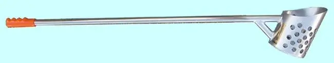

High grass and foliage has take over my woods and fields, so I'm deciding to venture to water hunting. . Looking for something that I can give a little kick to drive into gravel bars without destroying it. Any advice on a good quality scoop with limited funds? Perhaps something under $100?

Look up RTG scoops on the internet. If your budget is around $100 bones, you can get a decent stainless steel scoop for around that. Here's one for $110.00
It's light weight and will stand up to your foot pushing into gravel and rock. Hope this helps. Good luck and happy hunting. IGH
Since saltwater isn't going to be an issue, locate a length of 6" galvanized tubing and have someone weld you a 3/8" piece of galvanized pipe in the shape of the old Miller scoops (you can look these up online). When I lived in Indiana this is all we used, extremely tough, lightweight, and the Miller style handle provides a lot of leverage. This also allows you to drill your own holes and we always added/cut a 3/4" serrated edge into the bottom lip of our scoops to help with rocks and gravel. $25 - $50 and you're done and this scoop will really take some abuse. :thumbsup:

Also, depending on the size of the gravel, a pull scoop like this would be easier to scoop medium to large gravel. Then dump it on the bank or in a floating inner tube sifter. If the gravel is to large it will not sift out well of a regular beach scoop and pulling gravel is easier then trying to push a scoop with your foot in to gravel.
This scoop is 18 ga $40+shipping
Thats the one I have. Its a beast.
