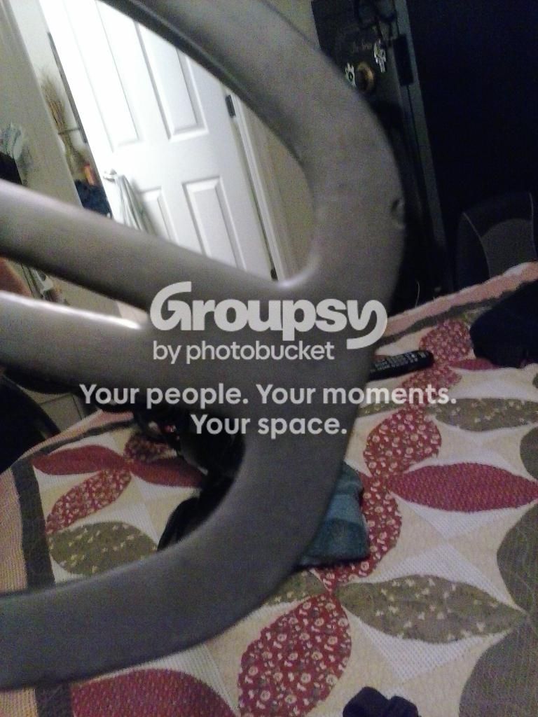

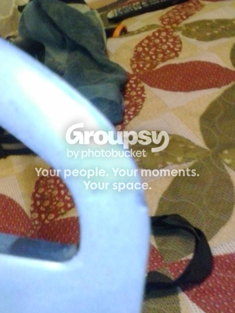

Today, as I was cleaning up my ATP after a quick romp through the woods I noticed a "chip" in the epoxy on my 5x8 coil (there on the front edge) when I took the coil cover off to rinse it. Is this a concern? I dunno if it was there from the factory or what. I don't recall smacking it against any terrain, stumps etc. but, perhaps I did? At any rate, the detector seems to work fine...at least to this noob! Is this a common occurrence and I need to just calm down?!
ETA: Sorry for the crappy resolution - crappy cell phone.
Pretty common for epoxy filled coils...Myself i use the 12 dollar cover and have never had that problem
Yep, I keep the coil cover on 24/7. When I noticed it; was when I took the cover off. As long as it doesn't effect anything I guess all is well...
The coil will still work fine. But be aware, now that it has a chip it will continue to grow that much easier each time you smack it on the ground, a rock, tree stump, fence, etc. Just as DustyTrails stated, buy a cover for it and with care the coil should last a while.
I would think you could just fill the small chip with epoxy never had any problems with a cover already on thats pretty strange
Yeah, I'm thinking that maybe there was an air bubble trapped under/in the epoxy as it dried and the first slight bump it chipped off or perhaps the epoxy stuck out a little past the lip and when I grabbed the cover to pull it off; my fingernail caught it etc. Eh, whatever...as long as it won't diminish performance I guess I'm cool with it. I'll just keep an eye on it. What kind of epoxy would I want to get if I chose to do a DIY repair? The factory epoxy reminds me of JB Weld.
I would get some general purpose epoxy from the hardware store
I use marine epoxy. You want water proof epoxy, other wise if you're using it in the water lots, the general epoxy will crack off faster than the marine epoxy. Go to a boat or marine shop and ask them.
Thanks Guys for all the input. Yes Irish, I think that sounds good and I have a marina right down the road.
As long as you stay away from the five minute cure epoxy, check the label to see it is waterproof. Marine epoxy is going to be expensive. I would stay away from JB-Weld as it has some metal in it.
West Systems slow-cure epoxy rules!! Gotta roughen up the chip a little, clean with acetone. A little drop of epoxy, and you can put a piece of wax paper over it to maintain a flat surface, the wax paper won't stick when the epoxy cures.
