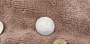

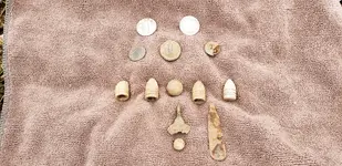

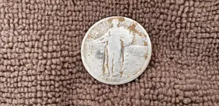

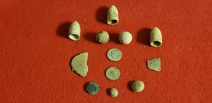

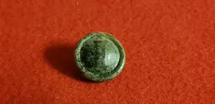

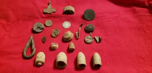

Some Deus/Orx finds from a mineralized farm field over the past few months primarily using the Gold Field program.

Vferrari, wow ask and thee shall receive! Have to update my info, unfortunately I no longer have the infinum. I will try all this, and Ive been avoiding gold fields and pitch tones for too long, taking the familiar goldmaxx route, this will build a fire under my bottom and make me a better deus user. Nice saves BTW, Ive only found 2 rebel buttons ever, ones an "I'' block. Thanks so very much
Good luck on that hunt and don't get flustered because pitch is going to sound weird, but stick with it and you should be rewarded. That block I was my first CSA button. Finally broke through after all these years. Lol.
