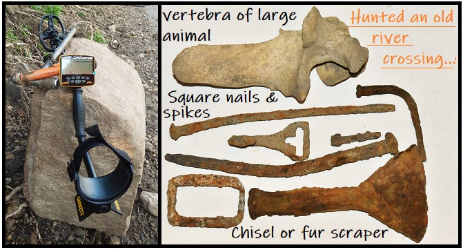

I did metal detect in some old parks, in the woods, river bank and shallow water. One spot I spent several hours at, got me the usual iron targets, which by the way were plenty. In amongst the iron nails and spikes , I got a nice stable signal and pulled out an old musket ball. Throughout the search, I also got some more spent lead, shotgun shells and a variety of other finds. The separation of this new 6" x 11" DD Viper Searchcoil, seemed adequate. Several people have already used Monte's "Nail Board Test" as a reference for target separation and were quite pleased.
I spent an evening hunting an area along the North Sakatchewan River, which was at one time used as a snow dump, from ploughing heavy snow from roadways. I got the usual fishing tackle, some coins and aa few older relics as shown.
