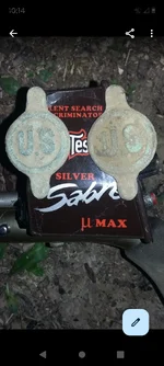

I came across a small civil war picket post or campsite here on my own land. I discovered it with a Tesoro silver sabre uMax with the small 6 inch white coil. I found 2 civil war US bit bosses about 10 feet from one another and some cast lead where they were making bullets.
So I searched and searched on and off for about 8 years..I used an F75, MXT, nokta racer, dfx, Anfibio, racer 2 with a 13 inch coil and a few other units all in the same area. I only found 3 more fired bullets.
It took about 8 years before I bought my first XP detector and I bought one shortly after they released it. The ORX is not a multi frequency unit but has selectable frequencies with the 9 inch HF coil going up to 31khz.
As soon as I started detecting with the orx in the exact same area I dug another 21 fired musket balls in a period of about 3 days....they were all 8 inches and deeper that were masked by bits of iron and square nails and that was with a 9 inch coil using 31khz.
I had an old farm house I would try detectors on too. I used the exact same machines that I tried on that little civil war camp here at home with at that old farm house.
It was to where when I would take a different detector there that I was not finding any more coins or good signals.
When I took that orx there the first time to try it out I found 9 coins in the exact same area near the front steps that I swung all of those older flagship models over within a 45 minute time frame. None were silver but a lot of them were next to iron or on edge
That sold me right there on newer technology and I have not stopped trying to get a detector that performs better than the previous ones ever since
Now I have other XP units as well as a Nokta legend 2.
Yes my units cost a bit more than 400 bucks but if you get a pre owned 1st generation legend or even a used XP ORX I think your finds will go up a bit ..or at least wiggle out some goodies your tesoro and fishers have missed next to iron and old square nails.
I think you would enjoy it!
