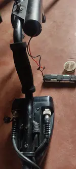

If your speaker has its screws in it get 2 3/4 inch copper wall pipe clamps then you can attach your control box with those. Give me a little bit and I'll find my post showing how I did mine.

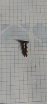

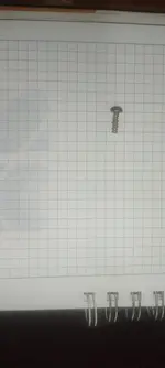

Maybe that helps. I had the same problem. Also, I changed that battery box; the original one is now sealed forever, and I hooked up an extension made from the old Minelab Excalibur battery casing.
Is that picture of the self-tapping screw, the screw that should be used?
Thanks, that's a good idea to give it a little more rigidity., but I woiuld still like to secure it with the proper screws too.
I probably have a couple like that in the junk drawer ! I'll sort through my hord before going to the hardware store.

Yeah I did that after having 2 control boxes snap at the original mounting screw spots. On the 3rd control box I put these on . Normal wear probably wouldn't break the box off but swinging it in the water puts extra pressure on those two original mounts, the water pipe clamps make it rock solid.
