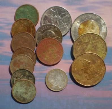

Found the machine stable at this setting and very good at picking up deep coins in the 8 to 10 inch range. Had plowed this field numerous times with the Freedom 3 Plus. Pennies rang up good as did loonies and twoonies but dimes and quarters were not to be done. Tried an air test and the machine still would not pick them up at any level.....need help there. Did get one dime and I suspect that it was becaose it was a 1968 one which is half silver which rang up at 82 on that display dewie. The quarter was laying on the surface I eyeballed!
Will it replace my half working Freedom 3 Pluses.....not at this stage.
Duration of dig was 1hr10
Coins found 14 @$4.52

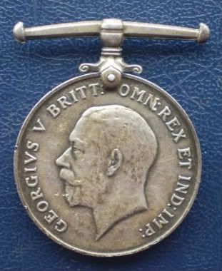

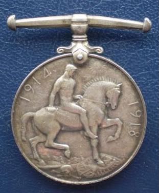

On another note got to going around a few goodies that Maw had left me which included this. Don't now much about it other then it was her father's medal.
