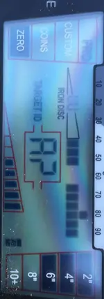

I received my new AT Pro this last Wednesday. Since then I've put about five hours on it. It's help me find some coins including an 1897 Barber. Today, I noticed pixels or segments of the screen did not work (illuminate. Turn black). I changed batteries, undid and reconnected the headphones and coil. Not fixed image.webp
The following segments do not work:
"Coin mode" segment
The bottom segments of the VID - this should read 82 in the picture
The 55 and 60 notch segments
The three lowest sensitivity segments

That's a different problem with the rainbow effect. The OP has a bad LCD or loose ribbon cable to the LCD if it's missing segments.
