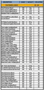

You can copy this chart and carry it with you

Yes! Thanks for the chart!
