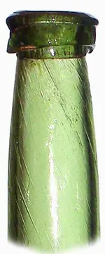

The age and collector value of the bottles is unknowable without images of the neck and lip-finish. I, like other commenters here, am skeptical. I see nothing so far to indicate age beyond that of a Mateus bottle. I see no indication of a pontil scar, and certainly not an imaginary scar "glazed over with a torch." The wear on the bottom of the bottle may be an indicator of long usage, but that wear is easily faked.

Here are a couple of bottles which demonstrate the stretch and twist of glass in the neck of early (the first example dates to 1770 - 1790), hand-blown bottles. I see none of that in the 'Mateus' bottles under discussion. Is your friend trying to get you to do something that is too unethical to undertake himself?
